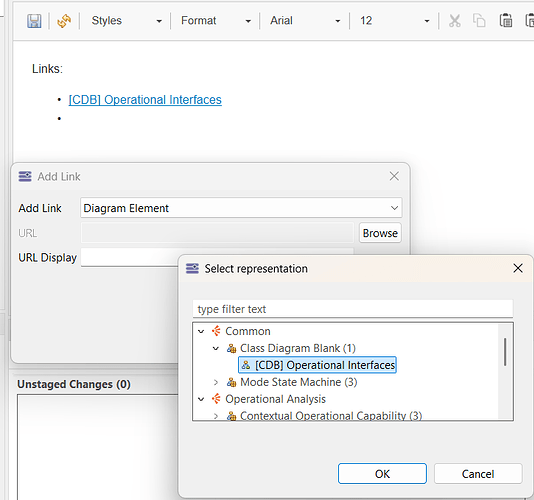

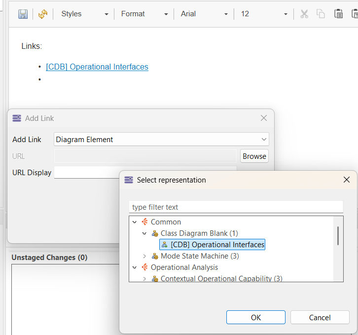

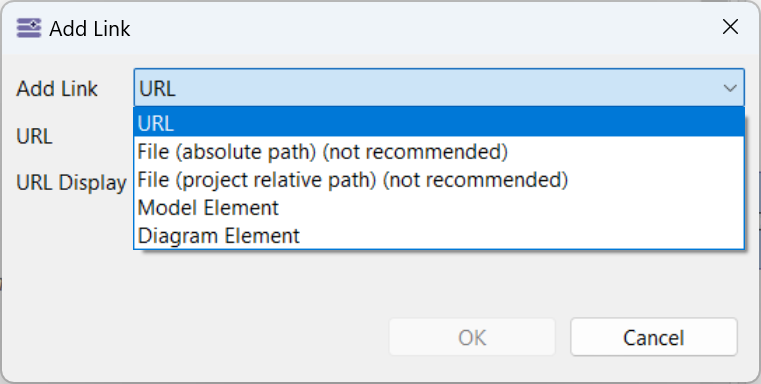

In the Capella 7.0.0 model documentation, when I use the “Add Link” button, I can choose between URL, File (absolute path), File (project relative path), Model Element, and Diagram Element.
However, it seems to only ever input plaintext (there’s no blue, or underline, and it’s not clickable). When exporting to HTML, the text is also not clickable. It’s exactly the same when I ctrl+V a URL. Just results in the plaintext name of the webpage.

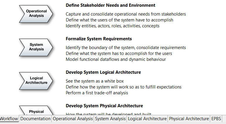

There’s still some issue. :persevering_face: I do get a weird behaviour when I move from the Editor back to the project Documentation tab (to the right of the Workflow tab shown). If I click anywhere in the Documentation tab, all the links in the editor instantly disappear and need to be created again. You can imagine this is rather frustrating.
