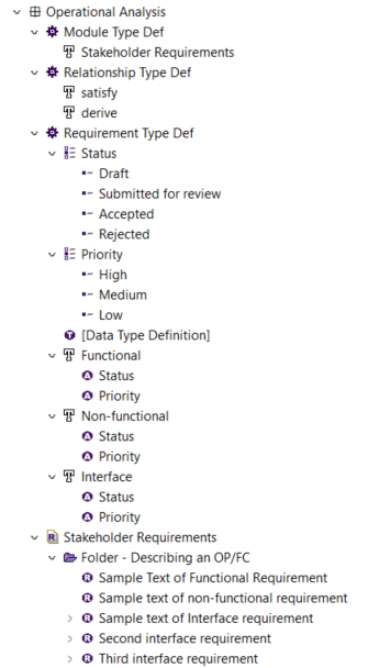

I created three requirement types: Functional, Non-functional & Interface.
Each of the three requirement types have two attribute definition enumeration: Status & Priority. (They are all linked to their respective Enumeration Data Type Definition as well.)

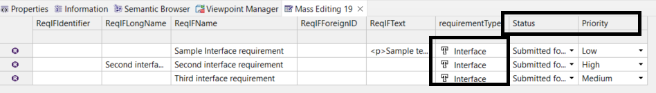

I have observed that when I send multiple requirements (belonging to different requirement types - for eg., some are functional and some are non-functional) my new attributes Status and Priority do not appear in columns.
However if all requirements are of the same type (eg., all are interface requirements) then these columns appear.

More details on my structure for context if needed

Answered on this thread: Issue with mass editing view when different requirement types are selected - #2 by StephaneLacrampe
I’ve seen similar behavior when mixing different requirement types in the same selection. It feels like the mass edit view only properly handles fields common to all selected types. Splitting the selection by requirement type first worked more reliably for me.
