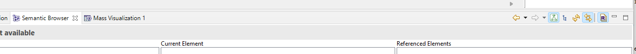

The workaround for you is probably to go on the semantic browser and active the “R” icon as on this image. This will change the behaviour of your table as well, and you should see your attributes properly:
