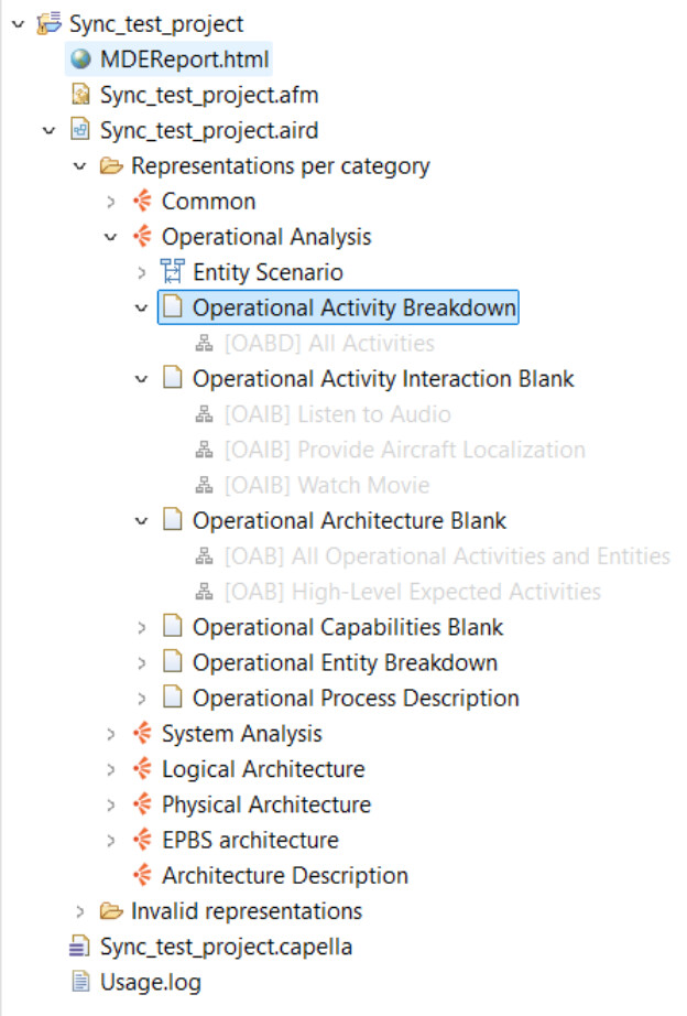

My goal is to have a SharePoint Library as the model workspace, sync’d to the desktop of each user. Though it wouldn’t allow concurrent edits, the sync’d library would still be valuable for model collaboration and version control.
The issue is, when I try to open a project from someone else, all the diagrams are greyed out, and I can’t open anything. Is there a reason why representations would be greyed out like this?
Yes it looks like you have invalid representations. This means that somehow your model got invalid. Why/How I don;t know.
