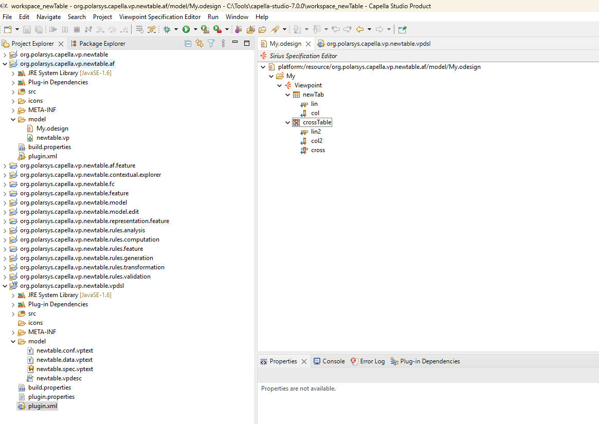

I have a need to create a traceability matrix in Capella with custom selection (for example SA Capability vs OA Capability, SA Capability va SA Capability,…) It can be within OA, SA, LA or between their various items (Capability, Function, Actor,…). Do we have any one tried to create such kind of add-on ?
Many thanks for your help.
I try to create a viewpoint DSL on Capella Studio 7.0, and use .odesign to make cross table with Sirius.
I got inspirations from Basics Requirements Viewpoint source.
My source here : on github repos traceabilityCustomCapella
The issue : it works well to create what I need as traceability matrix capability - capability. However, when I tried to unreference/detach my viewpoint, it has bugs and I can not detach it from the model.
