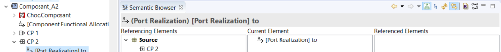

Here is what can happen if an object is destroyed while it has a realization link to another object. The realization link loses its ‘source’ or ‘target’, causing the model to become corrupted in some way.
