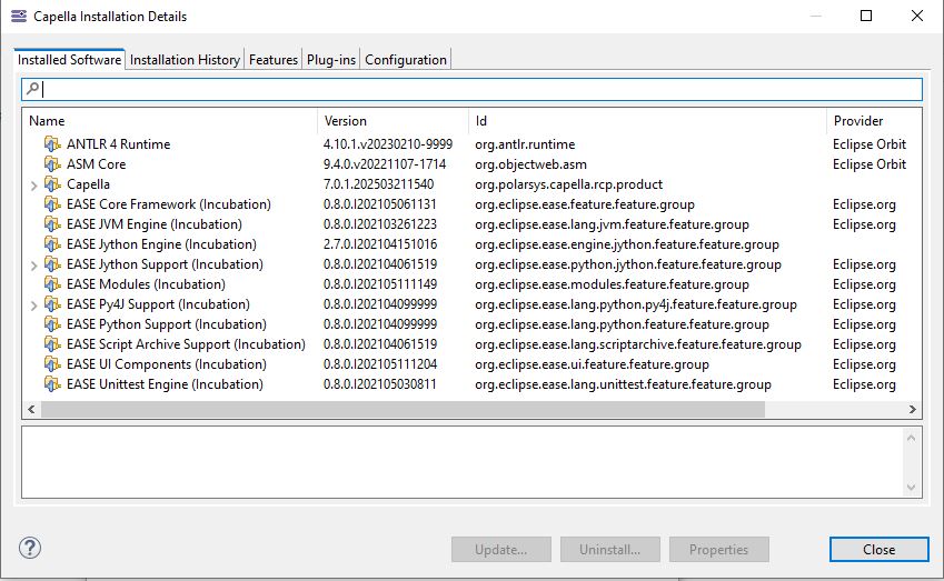

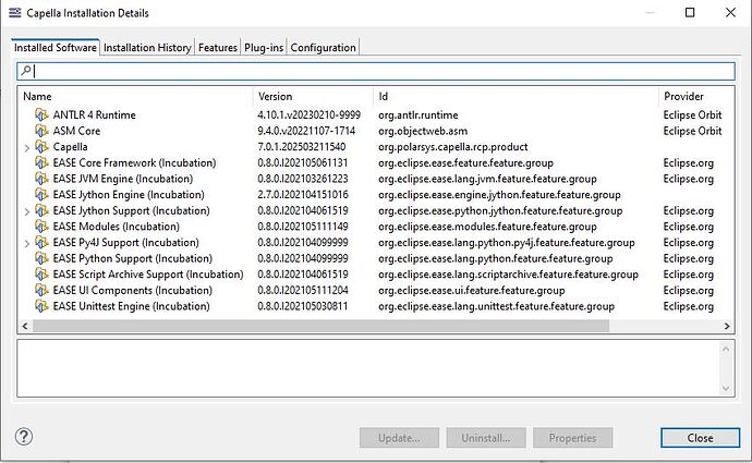

Hello and thanks for your help!
You can see here the installation details and the OSGi console output:
On the other hand, I have reverted the installation to the snapshot prior of P4C and so I can see the diagrams well.
