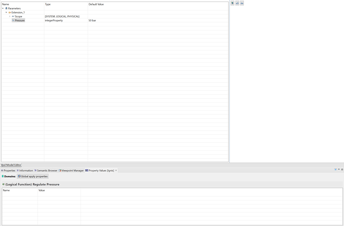

PVMT - I have installed it successfully, got the PV configuration, created domain, enums, etc. Now I wanted it to assign this createds property to the model elements, to do it I went to the property view there I can only see the created domain and glopay apply propert button and then a table down which is empty with name and values, I have no option to edit or do anything in for the two columns.
How shall I proceed, can someone please guide me on this? I have been through the video which had the created properties in the property view already.
Maybe a few screenshots would help to see what the issue may be here.
Please find the attached image.

Would be interested to see what you have defined within your scope element.
Let’s say you have defined the scope to be on Logical Components for example, then you would have to click on a Logical component in your model to see these property values appear in the PV property view.
