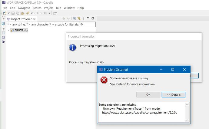

I try to migrate a Capella 6.1 project towards Capella 7.0 and I have this message:
Some extensions are mising
Unknown RequirementsTrace from model ‘http://www.olarsys.org/capella/core/requirement/6.0.0’.
However, I have insert Requirements-dropins-0.14.0.202407170938.zip in Capella dropins file.
Could you help me?

in Capella 7.0.0, legacy Requirements were removed from Capella M2 and extracted as their own viewpoint (now part of GitHub - eclipse-capella/capella-basic-vp)
the requirements 0.14 you are talking about, are a different addon GitHub - eclipse-capella/capella-requirements-vp: This add-on allows importing a set of requirements from a ReqIF file

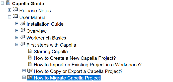

In order to properly migrate your project, please take a look at the Capella documentation
It contains the different procedures, whether you want to keep the legacy requirements data, or to remove it .

Hi Erwann,
Many thanks for your answer. It works. I migrate projects since Capella 1.3.1 and so I didn’t look at the documentation anymore! big mistake :slight_smile:
