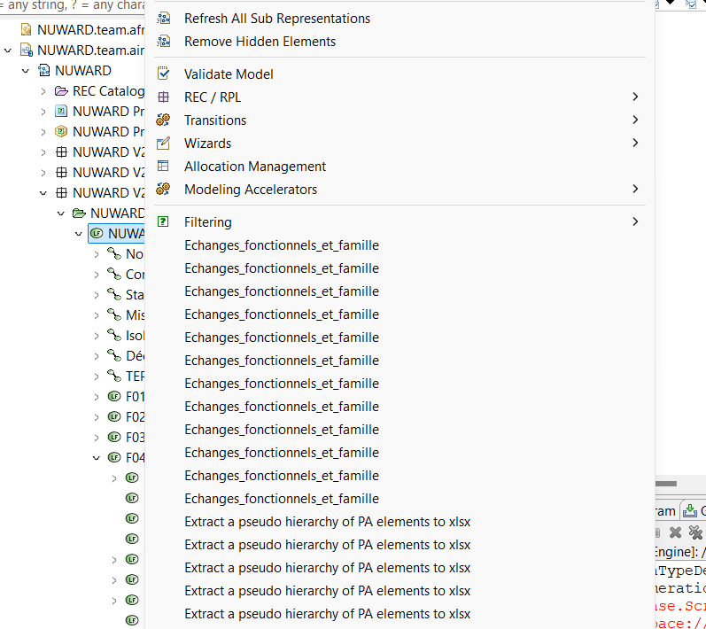

Is there an option to suppress the list of Py4C previously used in the right-click toolbar?
Thanks.
Thanks.
From Python for Capella, the only way is to remove the script or its header. You can also move the script outside the script locations defined in preferences. For more control you will probably need to use Java code.
