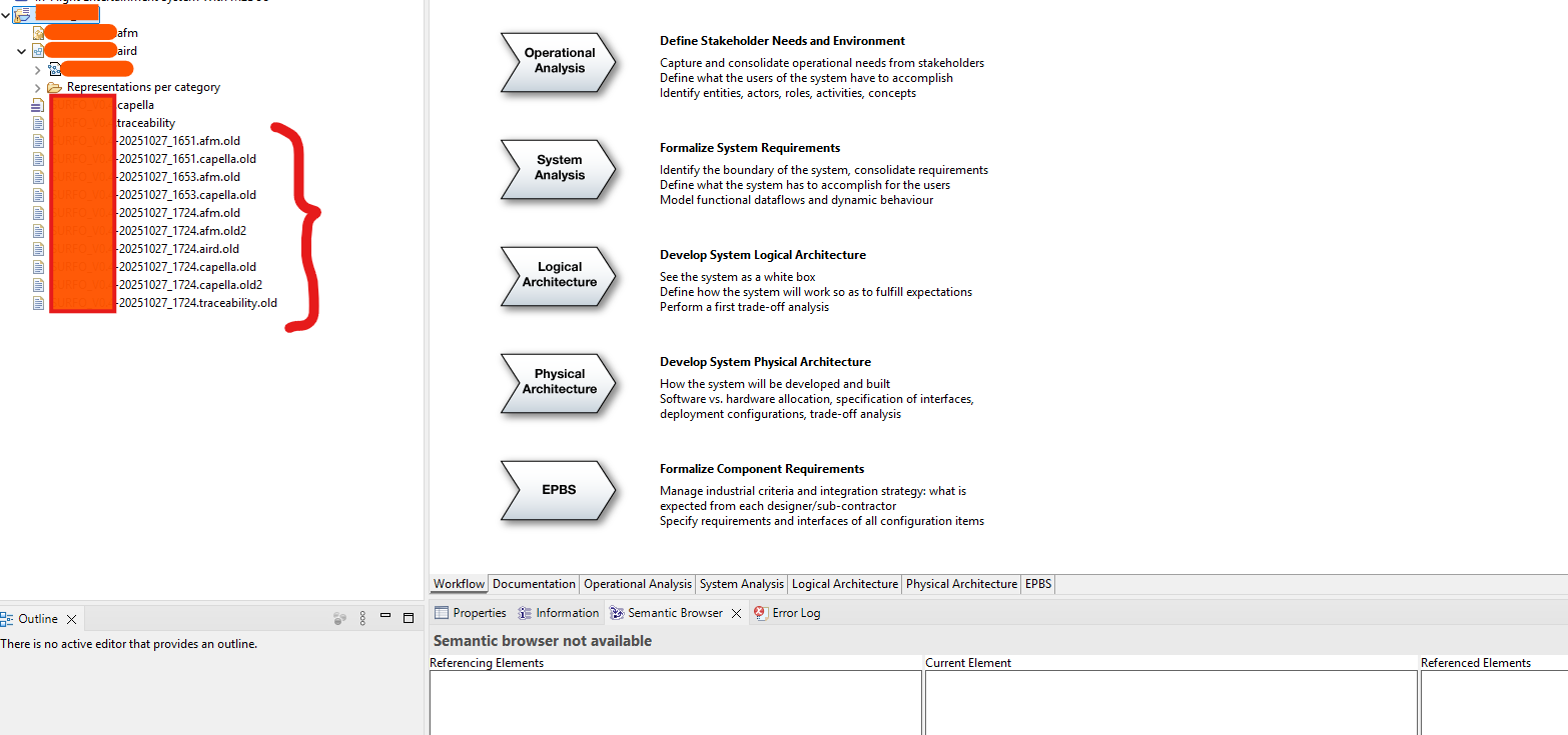

Hi all,
After a model migration from Capella version 6.2 to 7.0.1, different files “.afm.old” , “.capella.old”, “.aird” and “.taceability.old” have appeared on the working space. Does someone know where do these come from ? Is it redundant with the already existing files .afm, .arid., .capella and .traceability ? Is it possible to delete them without impcating the model ?
Thanks in advance
These are the old (pre-migrated) project files. Essentially they’re a backup created by the migration function. You could delete them, but if you subsequently found a problem with the project’s migration you wouldn’t be able to roll back.
