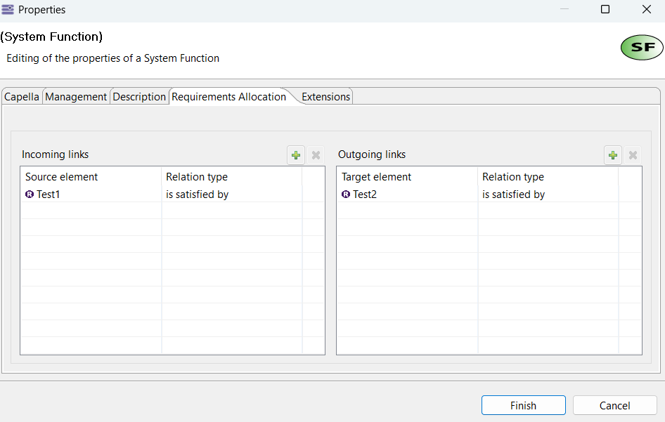

I am trying to elaborate traceability matrices between requirements and system functions (or generic capella elements) using M2Doc, and having troubles trying to access the requirement allocation field within a generic capella object (e.g. a system function).
So far, I was able to build the traceability matrix from requirements to a generic capella object (e.g. system function) using the following query in the M2Doc word template
self.eAllContents()->filter(Requirements::Requirement).eContents()->filter(Requirements::AbstractRelation)->select(r | r.oclIsKindOf(CapellaRequirements::CapellaIncomingRelation)).target.getName()
which provides the list of full Incoming relations I defined for each requirement (Not sure if this also is the best query I can make).
I would need a query that for each capella object (e.g. system function) returns the list of allocated requirements. Specifically the list of reqs in the screen below for a generic system function
