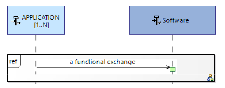

You can use the Reference tool in the tool palette for that:
It won’t display the actual referenced scenario, but you can navigate to it by double clicking.

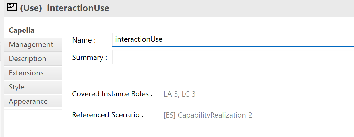

You can also go in the property view of the reference you created to add the “covered instance roles” so that your reference spans across all the actors/components that it covers:
