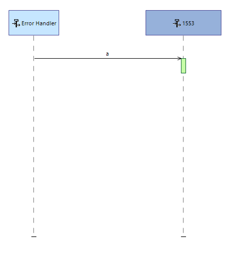

It is possible to reduce timeline in a sequence diagram ? Even when clicking/mooving the end of the timeline, it seems to have a minimal length.
What I have:

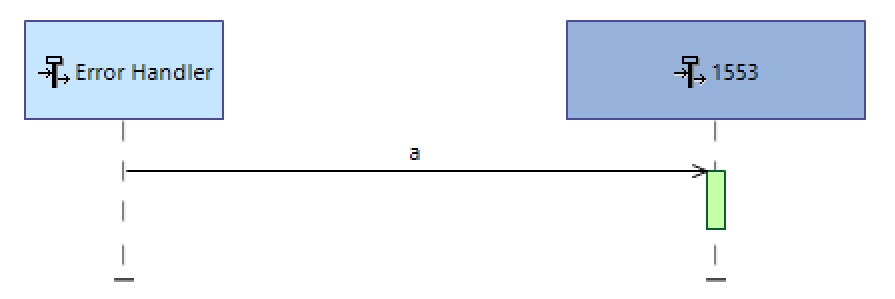

What I would like (On this picture, I reduced the timeline with paint) :
It is really anoying as exctracting sequences to images create big image for nothing.
