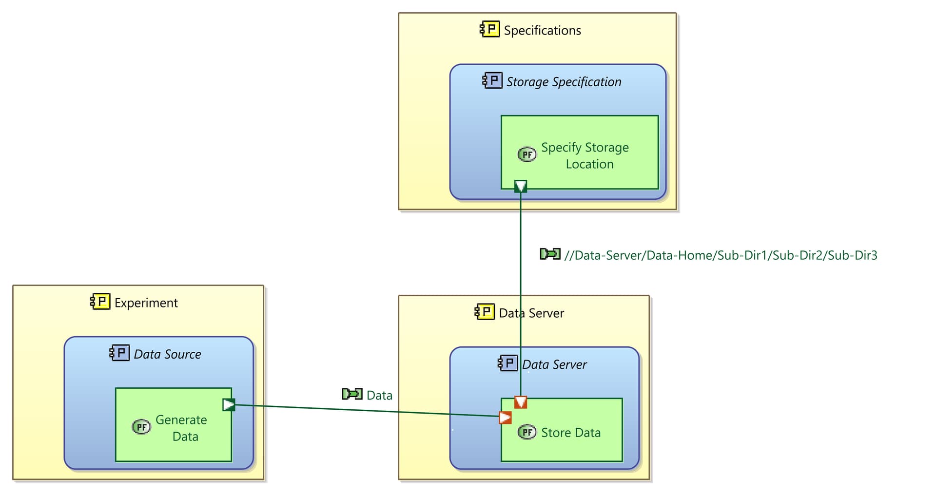

I am modeling a process flow that generates and stores data. How do I specify where the data is stored? I can see two ways of specifying data location. One is hardwired

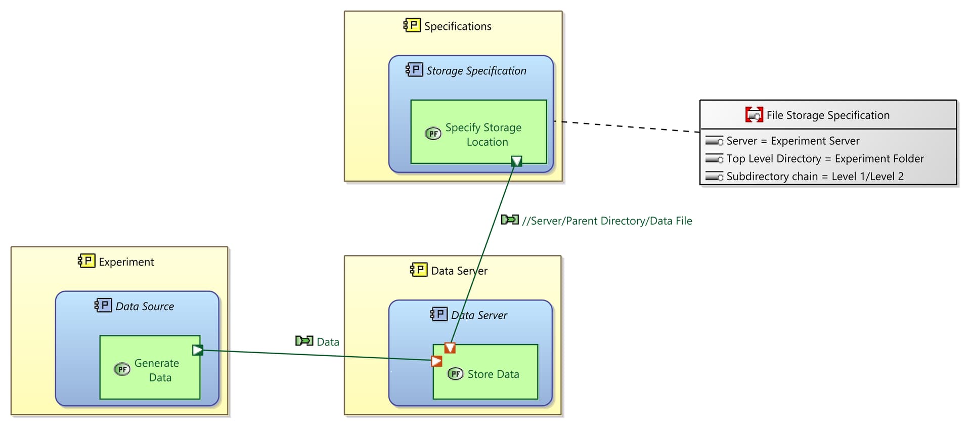

And the other via properties (I just came up with this, so it is half-baked)

If what you want to represent is that there is an actual functional exchange between the functions “Specify Storage Location” and “Store Data” that indicates where the data needs to be stored, then this data should be represented as an Exchange Item on the Functional Exchange.
