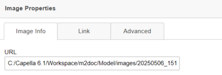

When someone add an image in the text section for a requirement, this image is created in an “images” folder. However, the path of this image is different for each model (see image below).
So, the URL works only for the one which added the image, but not for the other models.
