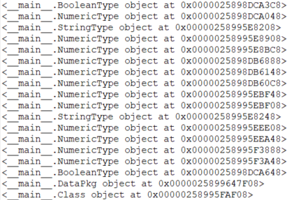

I printed all the possible data types and have been trying to use their objects.

You can use:
newAttr.get_java_object().setAbstractType(item.get_java_object())
I think there is a bug in the API.
Thank you, that works.
