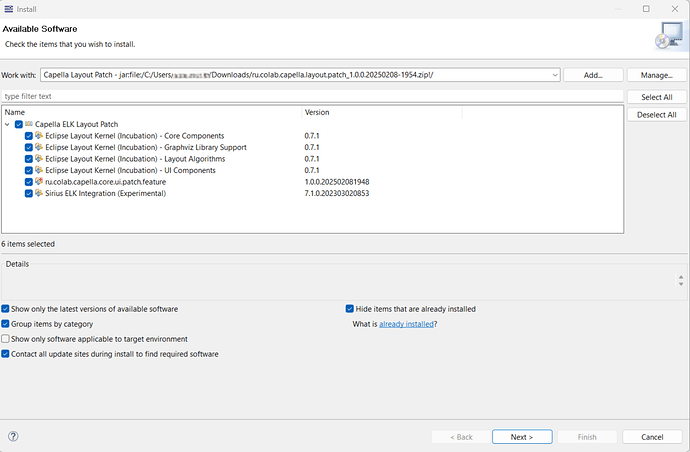

I see the problem on your first screenshot.
In the list of features that will be installed there is no ru.colab.capella.core.ui.patch.feature.
This feature contains all the jars that are missed.
The correct list of features is on the image below
https://github.com/open-modeling/CapellaLayoutPatch/blob/main/docs/images/InstallationGuide/AvailableSoftware.png
I don’t understand yet the reason why there is no the patch feature in the list in your case.
But I assume that the version of Capella in which you install is not 6.1.0. This patch feature is applicable only for 6.1.0

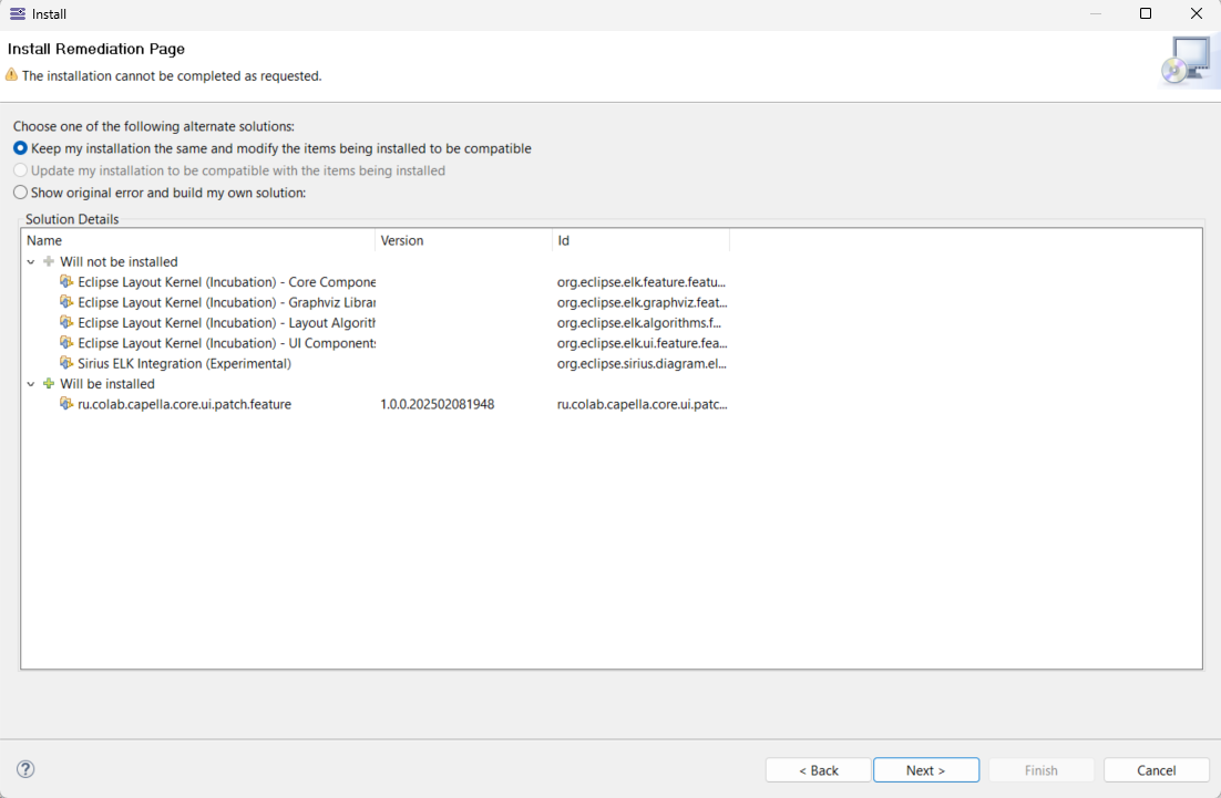

Thanks for your response. I have cross‑checked my Capella version, and it is 6.1.0. I tried reinstalling Capella and then adding the Capella Layout Patch. I am seeing the same screen as in the image you shared, but when I click ‘Next’, only ru.colab.capella.core.ui.patch.feature appears to install, while the other add‑ons are not being installed.
After I install ru.colab.capella.core.ui.patch.feature, then I try to install the other add-ons, I get the below error
Could you please provide any input on why this might be happening?

Thanks! Now I see the real problem. I will check
Have you tryed to install layout extension into CLEAN capella 6.1.0 installation? Or that was existing installation with some extensions already installed. Ifit was not clean, please try to install to new clean. Simply unpack capella zip archive into different directory, execute capella from it and try to install. After that we can try to fix the problem with existing installation.
