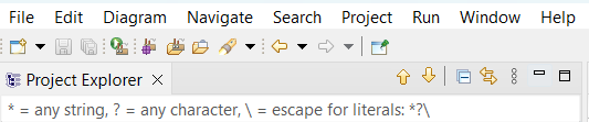

taking this old thread since I am having a similar issue. I add a Capella Types folder and it seems to do something (the *.aird seems to be modified) but not able to see it in the project explorer tree. I am trying to do what you are suggesting but not able to find the icon corresponding to the Customize view. I am using Capella 7.0.0

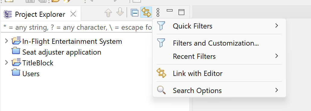

This is the set of icons I have near Porject explorer. Also clicking on the tree vertical dots, can’t find the option you are mentioning
Thanks in advance for any help!
I think the option is actually “Filters and Customization…”

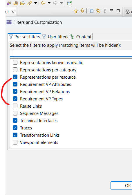

Still not able to visualize the capella type folder though, even if the three fields you were mentioning are checked :confused:
Yes, the trick is actually to… uncheck them (see the text mentioning “matching items will be hidden” - I reckon this is not obvious to say the least…)
Sorry, I totally missed that! :melting_face: Working now
