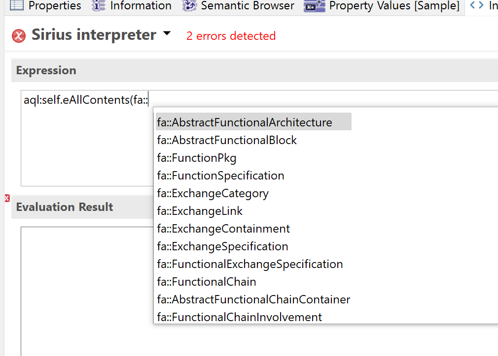

I am using extensively AQL both to support model editing and template testing. I found that auto-completion does not support all metamodel packages. As an example fa:: is missing.

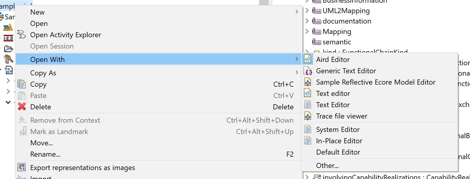

By opening the .aird file of the Capella project with the Sample Reflective ECore Model Editor

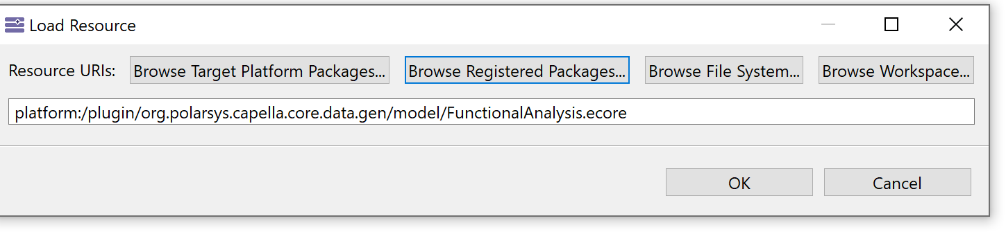

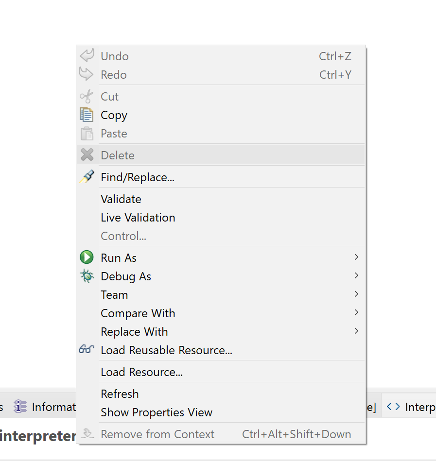

and selecting “Load Resource…” by the context menu

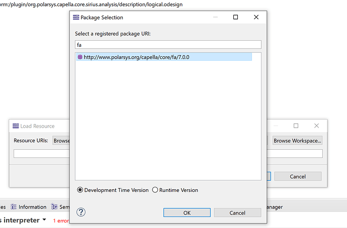

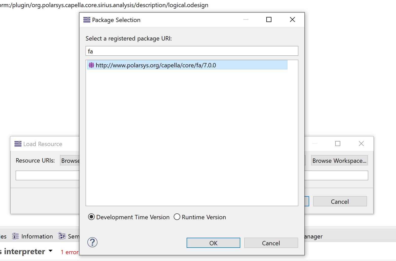

it is possible to load the ECore mode containing fa package with “Browse Registered Packages”
Once the ecore model is loaded and open the auto-completion is enabled.
