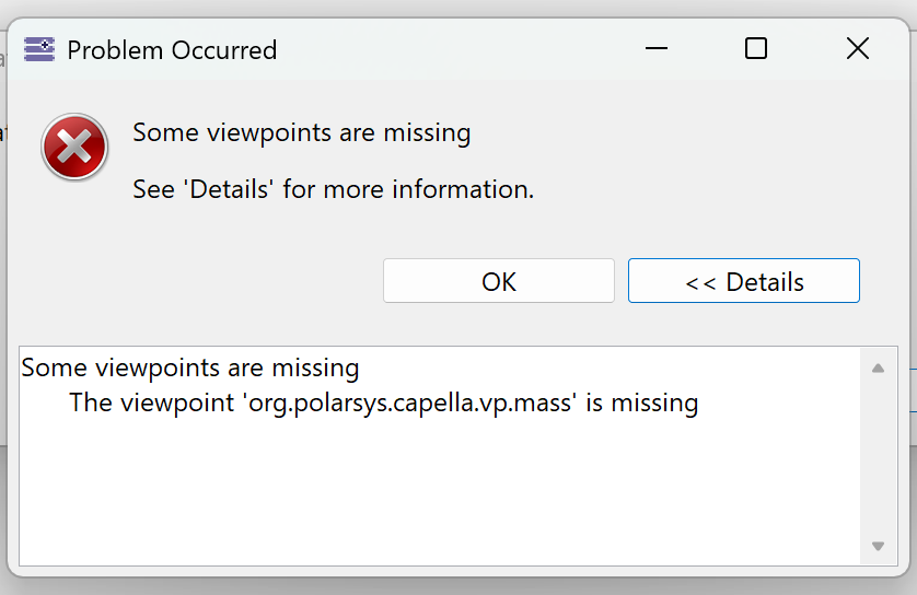

I’ve now tried it with 6.1. The following error pops up when started without migration:

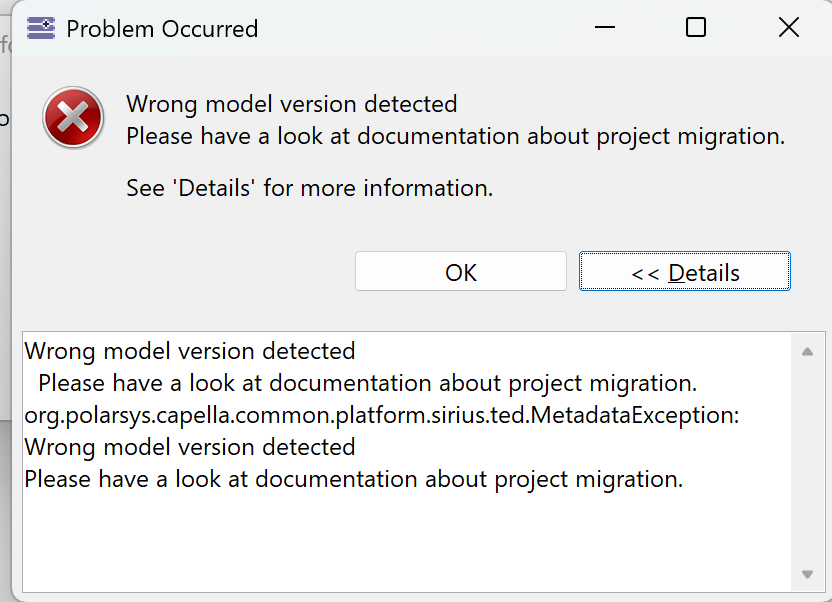

When I perform migration (to/with 6.1) I get the this message at the end:

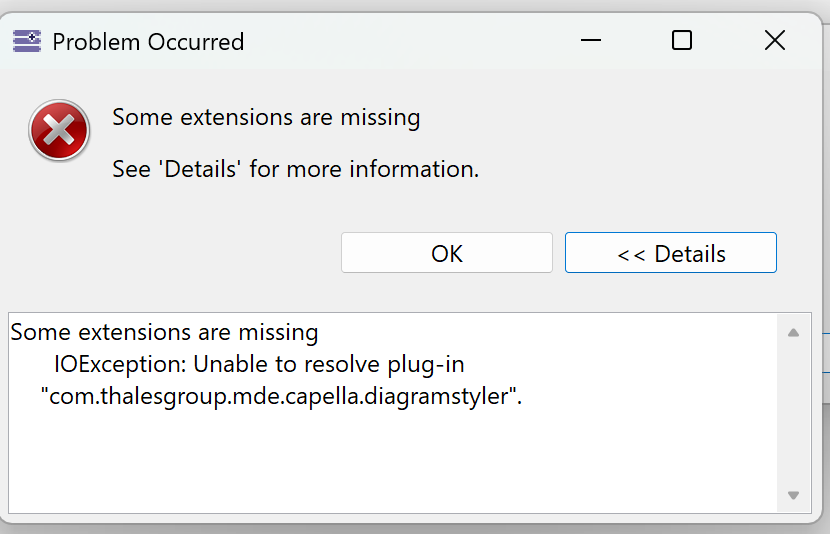

or alternatively:
Yeah, so this is not a migration issue, whether you want to open it with Capella 5.2 or migrate it to a more current version, you will need to install additional required add-ons :
  • From the AIDA home page you pointed out in the first message”Required environment : Capella 5.2 with the following add-ons : PVMT + Diagram Styler” which means that you need to install the PVMT add-on
  • the last error would indicate that there is also a dependency to the mass viewpoint
You should be able to do the migration directly from Capella 7.0.1 if you have those 2 add-ons installed.

Sorry I should have said that: DiagramStyler is part of PVMT.
It works now. I am having a steep learning curve!
