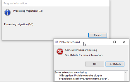

Does anyone succeed in migrating a Model containing requirements from Capella 7.0.0 to 7.1.0?
My other model not using the work fine so far, but I’m an error message with all the models using the Requirement Viewpoint, as follows : Some extensions are missing - IOException: Unable to resolve plug-in "org.polarsys.capella.vp.requirements.design ".
Both versions of Capella (7.0.0 and 7.1.0) are configured with the same “requirements” Add-On (Requirements-dropins-0.14.0.202407170938 .zip).
Any feedback or help to come over this issue will be very much appreciated.

so maybe the old Requirements-AddOn 0.14.0 isn’t anymore compatible with Capella-7.1.0…?
