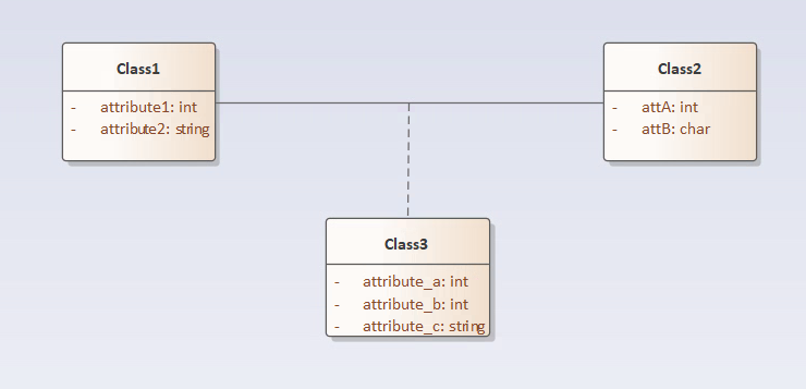

I would like to know if Capella support the concept of “association class” which is part of UML.
I cannot find out this type of artefact in the data model toolbar.
For example, in this sample below, the class named class3 is an Association Class.
Does such data modelisation is supported in Capella?
Thank you for your help .
