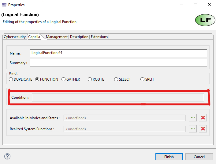

Hi all,
I would like to know how to use the condition field in function properties. It cannot be selected and there is no button to interact with this field.
Thanks in advance,
M.Hallia

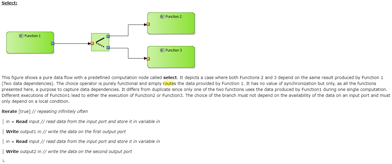

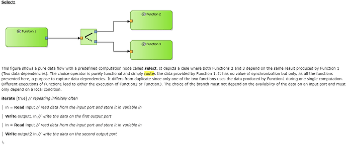

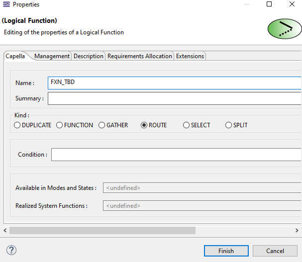

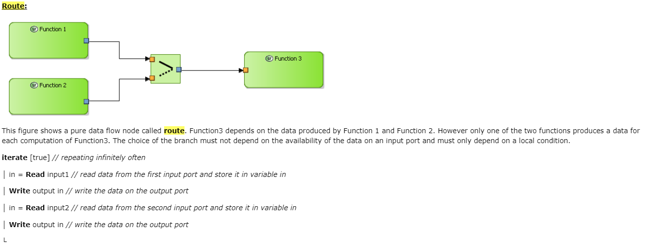

The condition field only applies to functions of kind “ROUTE” or “SELECT”. If you create a function of that kind, you should be able to populate that field.
Here are some definitions of those two function kinds, which are in the help documentation for Capella.
